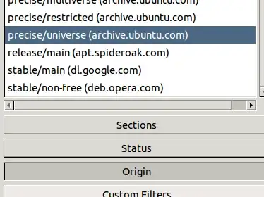

Installing gnome-core , brings a lot of packages and dependencies ,since it is meta-package .
One of the way is to remove it manually , but you should Know which Packages needs to be removed without causing any after-effects errors.
The list of Packages included are listed here Package: gnome-core (1:3.0+6ubuntu3) [universe]
Go to Synaptic manager (Install it if not present) , click Origin from Left-bottom Selections, refer image
Select the package for removal , by referring to the above link.
Caution if you don't know which packages to remove , then Don't follow this method . These may cause dependency errors.
