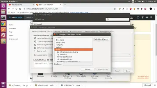

Change the server option in the Software and Update window and
click on 'select best server' like in this image:

One other thing I tried before I found this was kiran's answer to select the best server for package search. In case the steps aren't clear in that answer:
  1. Open Software & Updates, not Ubuntu Software or the Software Updater.
  2. On the Ubuntu Software tab, click the Download from dropdown.
  3. Click Other...
  4. In the Choose a Download Server dialog box, click the Select Best Server button.
  5. Wait for the speed tests to run.
  6. If the selection makes sense, click the Choose Server button.
  7. Enter your password when asked.
  8. Close Software & Updates, then agree to let it reload its software cache.
I don't know whether this really helped or not, but the suggested server was local.
