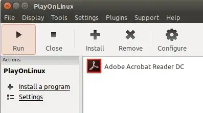

You can install PlayOnLinux (sudo apt install playonlinux) and then use the PlayOnLinux GUI to install and run Adobe Acrobat Reader DC:

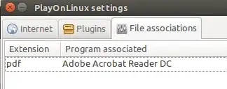

Within PlayOnLinux, you can then create a file association to PDF files:

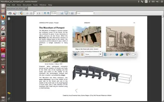

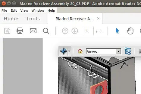

Then you can can right-click PDFs from your file manager, select to open with PlayOnLinux, and they will open and display:
This worked for me on Ubuntu 17.10 (64-bit) with PlayOnLinux 4.2.12 and Wine version 1.9.0. There was some little glitch that occurred during the installation process, but eventually everything seems to be working fine.
