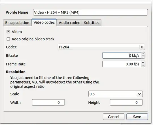

24
Use VLC.
From the Media menu choose "Convert/Save". Add your file(s) to the input and click Convert/Save button.
You'll then be asked to specify an output file, and you can choose a profile and tinker with it, e.g. here I scale the video by 50%:
screenshot
Click Save.
