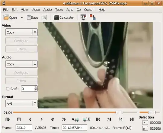

AVIDEMUX - It can resize and lower the size which helps in cases where the objective is to lower size. avidemuxInstall avidemux

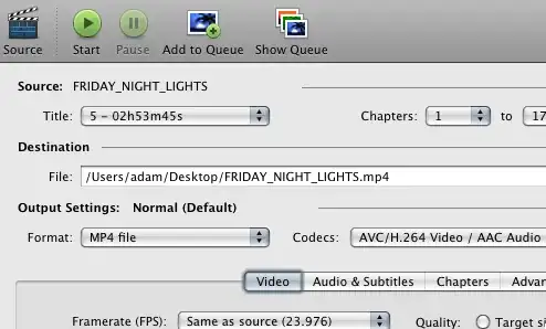

HANDBRAKE - Excellent tool for converting videos and optimizing size. I use it a lot when going from ogg to mp4 with h.264. Lowers A LOT the size. handbrakeInstall handbrake

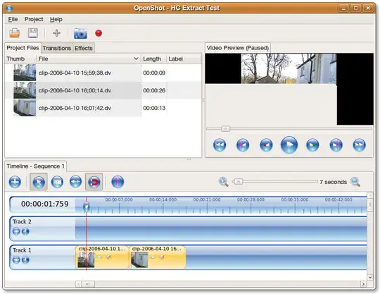

OPENSHOT & PITIVI - Both are good video editors tha can help lower size when rendering the video. openshotInstall openshot and pitiviInstall pitivi

Generally for such tasks, you could try Handbrake
HandBrake is a tool for converting video from nearly any format to a selection of modern, widely supported codecs
It should be in the repositories.
sudo apt-get install handbrake

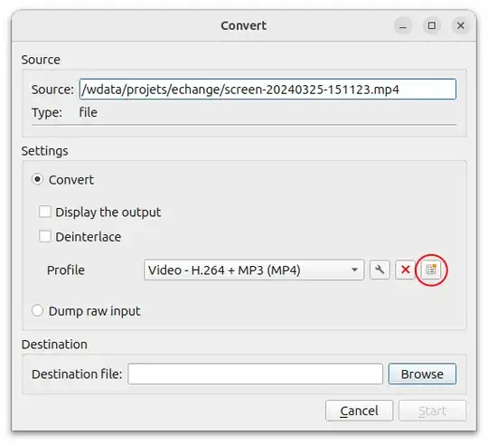

You can also use VLC for that:
  • Media > Convert / Save... (Ctrl+R)
  • Click + Add... and select the file to convert File selection
  • Click Convert / Save and select the "Create new profile" button Convert options

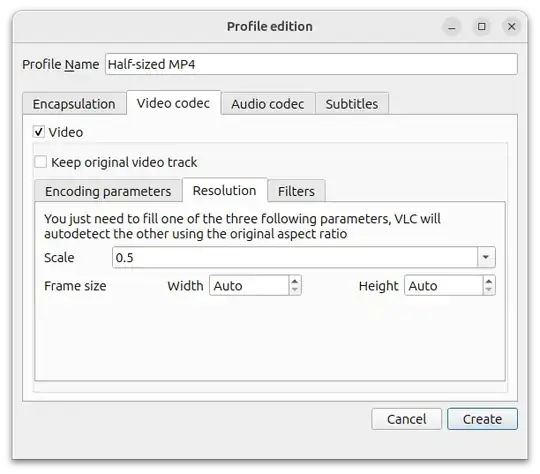

  • Give a name to the Profile Name, then in the Video codec tab:
    • make sure you check the Video checkbox
    • go to the Resolution sub-tab and either select a Scale or specify fixed Frame size: enter image description here
    • click Create
  • Make sure you selected a Destination file before clicking Start
Then be patient :)
