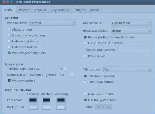

Just as an anecdote, even after configuring custom layout 're-use profile for newer terminals' has to be checked otherwise the new terminal again opens in default profile. enter image description here
