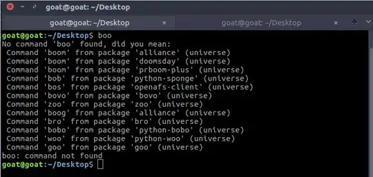

Yes, there is a way to automate it via -t and -e flags to gnome-terminal.
For instance, here's a script I've used quite recently for this question:
#!/bin/bash
gnome-terminal --tab -e "bash -c 'printf \"\033]0;TEST1\007\"; sleep 7'" \
               --tab -e "bash -c 'printf \"\033]0;TEST2\007\"; ping -c 4 8.8.8.8'"
What happens there is that there will be launched gnome-terminal window with two tabs , and each will run its own command. The rest is simple - open Startup Applications and add that script as one of the commands to be launched upon logging-in. Remember to make the script executable and give full path to script as a command.
