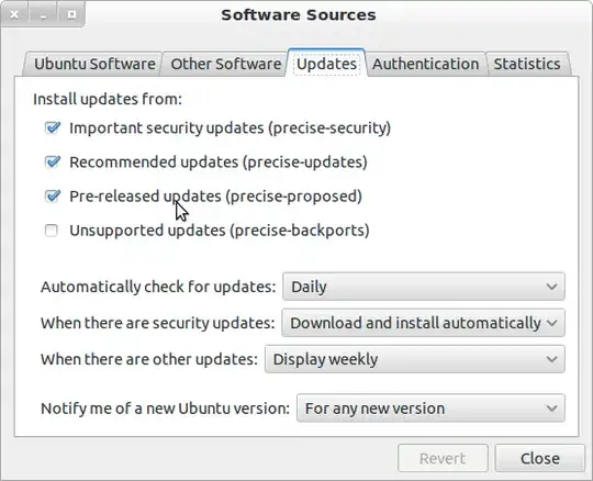

Libreoffice 3.5.4 is currently in precise-proposed repository. If I were you, I would just wait for it until it gets into the precise-updates repository and then you can simply upgrade your system as usual. But if you are quite desperate to try it out sooner, you can follow these instructions to use 3.5.4. You don't have to install an additional PPA, which makes it even better.
First of all, you have to enable precise-proposed repository. It is not enabled by default for various stability issues as the repository usually contains software that are not tested enough.
To enable precise-proposed, open Ubuntu Software Center → Edit → Software Sources → Updates and ensure that precise-proposed is enabled.
After enabling the proposed, use this command to install LibreOffice 3.5.4:
sudo apt-get update && sudo apt-get install libreoffice/precise-proposed
