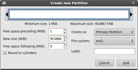

To accomplish this using the graphical hard-drive partitioning software that is called GParted then you can:
  1. Launch the Gparted application with super-user privileges; exercise caution!
    gksudo gparted
  2. Select the storage device containing the erroneously sized partition from the pull-down menu in the upper right hand corner of the GParted menu.
  3. Select the erroneously-sized partition by clicking on it in the rectangular partition map.
  4. Now you may choose to delete and create a new partition or you may choose to resize the existing partition. Regardless of your choice you will reach a menu that allows you to set the size of the partition. You must clear the "Round to cylinders" checkbox and set the size of the free space preceding to 1MiB. It will look similar to
GParted - Create new partition.

Just delete all partitions and do this with fdisk:
Command (m for help): c
DOS Compatibility flag is not set
Command (m for help): u
Changing display/entry units to sectors

If you have a windows dual boot you can use MiniTool Partition Wizard. This thing has saved my ass multiple times. Just right click the partition and click align. Don't forget to click apply.
