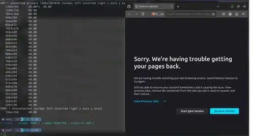

Then, in Deskreen, I selected Entire Screen and then chose Screen 2. It appeared blank but my cursor was showing and moving smoothly. I tried to use the command Shift+ Super and arrow keys to move an app (Firefox) to Screen 2. It didn't work. Then I dragged Firefox with the cursor to Screen 2.
This is how it appeared:
Ubuntu Screen
Trying to drag and move the Firefox window fully to Screen 2, it got stuck at the right on the Ubuntu screen this way:

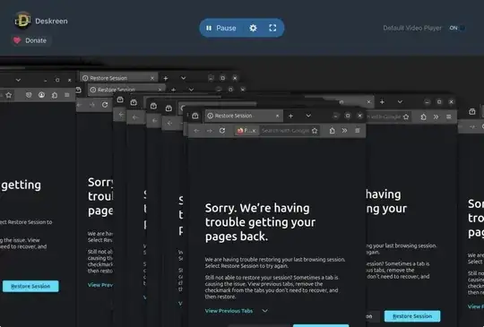

iPad Screen
It's like having a glitch, continuously flickering. Even after closing Firefox, the issue persisted. Also, I tried with another app (e.g. nautilus) and got the same behavior. And if it is a 2nd screen, why would it appear blank in the first place? Am I misunderstanding something?
