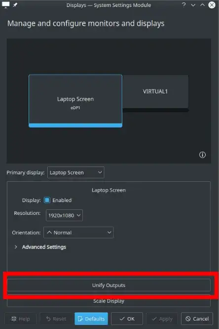

  • I had problems when starting the VNC server in step 7, the screen started to flicker and I couldn't see what I was doing on the screen. To fix this, I connected via the VNC server (the extended screen already works at this point), opened the Displays tool (the one that comes with the system where you can see the displays that are connected) and Unify Outputs then Break Unified Outputs (an example of this option in Kubuntu is shown below). Then everything worked.
Unify Outputs
