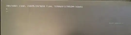

While using Ubuntu 22.04.3, I switched from the proprietary nvidia driver to nouveau in an attempt to get my second monitor working again. Upon reboot, the display was not detected.
So I reinstalled Ubuntu using a USB installer. However, now I am stuck at the screen above on a fresh install. The colored pixels appear after a few seconds.

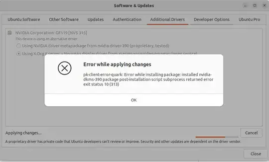

Via Settings UI
If I try to update the nvidia driver through the settings UI, I get similar errors.

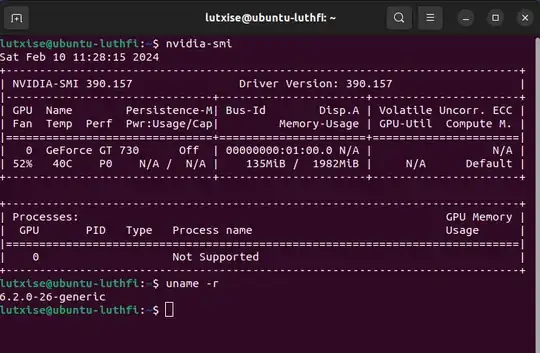

To fix this issue, you need to downgrade your kernel version from 6.5 to 6.2.0-26-generic. Once done, repeat the driver installation steps, and you should be able to install the nvidia-driver-390.
fallback kernel version to 6.2.0-26-generic:
