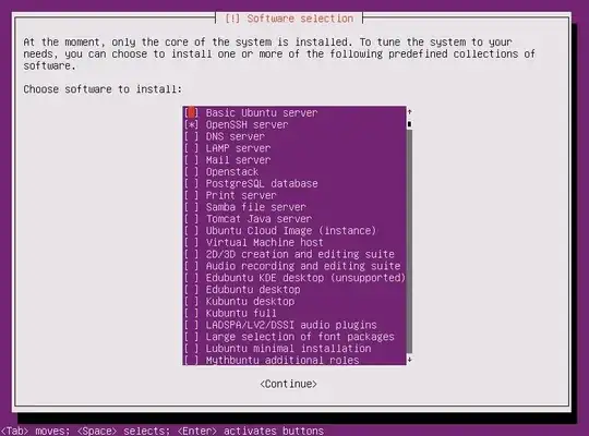

I'm installing Ubuntu from an Ubuntu Minimal image, and I've gotten to the software selection part. What I'm wondering is, which packages are included in the "Basic Ubuntu Server" option?
I'm assuming it's a bundle of packages, but which exactly are included in it?
