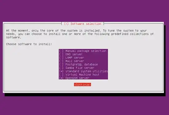

My googlefu has failed me. What packages are part of the "standard system utilities" that is preselected during install?
TIA! (-:
screenshot

I assume you mean on the software selection screen near the end of the install.
You can see the list of packages after install using tasksel
sudo tasksel --task-package standard
Your server will run fine with or without them and you can always install them later. They are all mostly convenience things like nano and ftp. If you want to save some space on your install unselect it and just install the utilities you want.
Here is the list for the 16.04 LTS release standard system utilities
