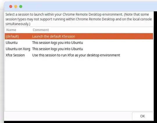

update on 26Dec2024 enter image description here
use chrome-remote-desktop finally works great after reboot. I didn't get the default ubuntu GUI but xfce4 GUI when remote-login. (choose the first option shown above for linux GUI desktop, the other options seems not work)
