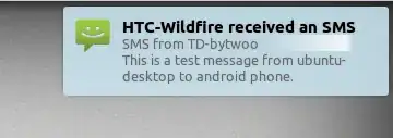

SMS Notification:

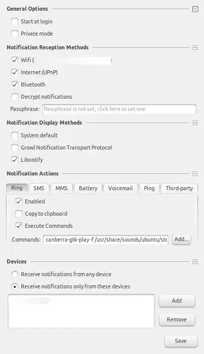

Install 'android notifer' on your desktop from here. After installing it , start the application (from accessories/android notifier desktop or search it in dash).It is still using using old gnome-panel notification area applet.So the indicator doesn't appear on unity panel. To run the configuration-window press Alt+F2 & type /usr/share/android-notifier-desktop/run.sh -p. This will open Android notifier preference.
If you want to use notify-osd select libnotify also install libnotify-bin package(sudo apt-get install libnotify-bin). Initially set 'receive notification from any device' from device menu.

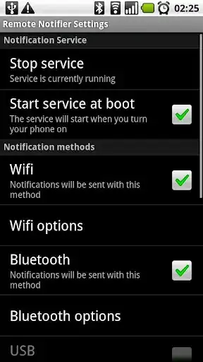

First install android notifier from here. or from the android market.
Start the application.Go to 'notification method' If you want to wifi (Both your laptop & phone has to be connected on the same wifi netwok.), select wifi, or if you want to use bluetooth select bluetooth.If you want to use your 3g network or over usb select the option accordingly. Get more help from here.
You can select events to notify under main menu->events to notify section.The default options are: Phone Ring, SMS, MMS, Battery, Voicemail etc.

Now go back to main menu & click 'Send test notification' to check whether it is working properly.If everything runs smoothly you will get a test notification as notify-osd bubble.
