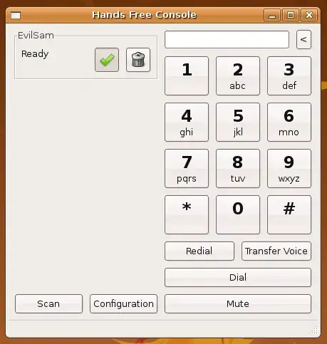

You can try this: http://nohands.sourceforge.net/
From the website description:
HFP for Linux is a Bluetooth Hands-Free Profile server.
It allows your Linux system to act as a speakerphone for your mobile phone. It aims to be a compliant Bluetooth HFP 1.5 Hands Free implementation, supporting all required commands and notifications, as well as streaming audio.
HFP for Linux was designed specifically for automotive computing applications, but it can be used just as well in a desktop environment.
You should try it to discover if it's compatible with your device.
Can install Hands Free Console by using ppa:sebastian-ruehl/nohands repository.
There is the list of packages needed to install, at Sourcrforge.
sudo add-apt-repository ppa:sebastian-ruehl/nohands
sudo apt-get update
sudo apt-get install libhfp hfpd hfconsole libaudiofile0 libspeexdsp1 libdbus-1-3 libasound2 subversion g++ autoconf libtool libspeexdsp-dev libasound2-dev libbluetooth-dev libaudiofile-dev libdbus-1-dev
