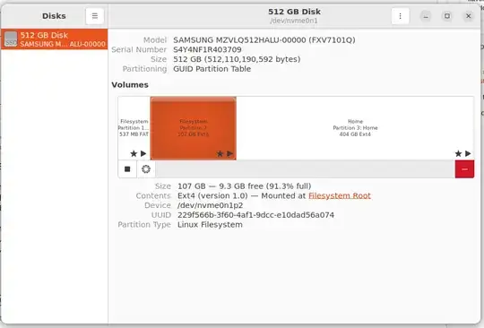

After following Quick GUI Fix, I was able to restore my files and directory /media/lance/Home back to /home. However, I can't find the files that were in my /home directory before, but it still occupies space in my / root partition. (91.3% full)
Disk Info

If I understand the mount command correctly, it overlays (makes inaccessable but not deleted) whatever is at the mount point.
For mount points, I usually make a directory with nothing in it then as needed do the mount command.
Whatever you have at the mount point prior to the mount command will not be accessible.
