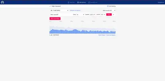

You can use this website in any Operating System to hear your own voice.
webcammictest
Select your input source on the top. Then set the Delay to "No", Speaker to your output source (in this case your headset) and adjust the volume percentage in the Volume section. After this press Start to hear your own voice.
