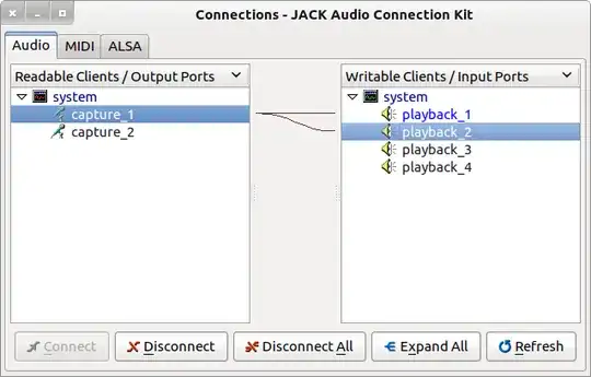

You can do it with jackd and qjackctl.
The program jackd is an audio sound server daemon for Linux, and its counterpart qjackctl is a simple user interface that lets you handle JACK audio server. From this you can virtually connect the output of your mic to your speakers.
You can install them from you terminal with:
sudo apt-get install jackd qjackctl
After installing it and running qjackctl, the connections mentioned will look like the following screenshot:
qjackctl app in action
Note, I am a professional audio editor and use it each week recordings sessions.
