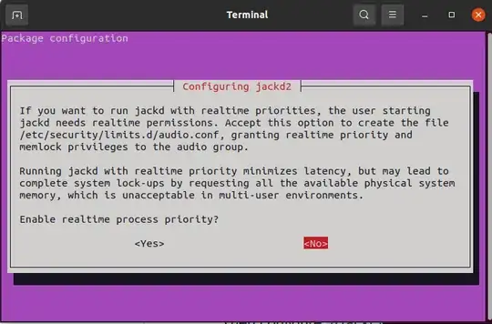

  2. Choose NO when you see this:

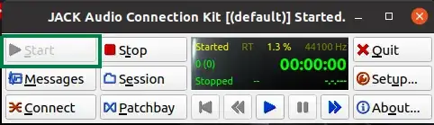

  4. Start JACK by clicking on the start button like so:

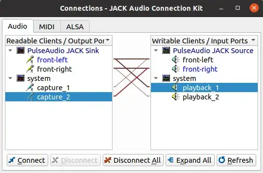

  6. In JACK UI, click the Connect button and have your devices connected like so:

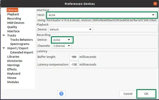

  7. Run Audacity and select Edit -> Preferences -> Devices and configure it like this:
  8. Start recording with Audacity.
