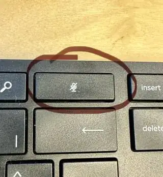

I have a HP 655 keyboard which has some quirks. One of them being for there is a key above backspace I keep hitting accidentally when typing which opens of all things “Settings”.
This is rather annoying so I would like to remap it. xev does not report key activity events even when Settings has launched which indicate to me that this require something else than xmodmap. showkey reports this to be 183.

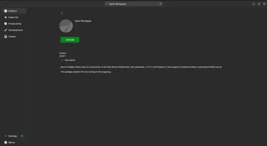

You can find the software in the Software Center (or App Center) on Ubuntu.
app-center-screenshot

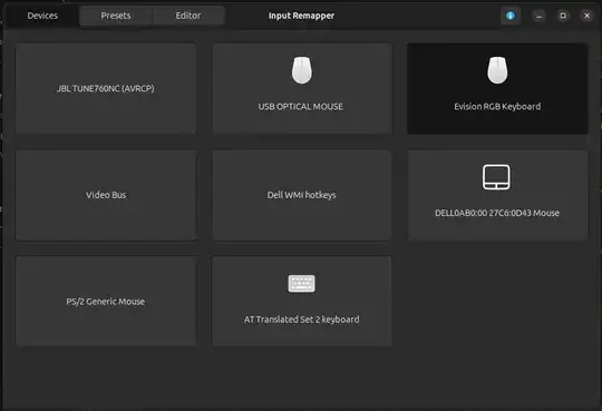

In the GUI, the software will list all the devices that are connected to your PC like this:
gui-devices

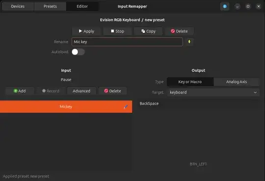

After selecting your device, you will get a window to edit your keys: key-mapper
In the above picture, you have to add:
  • Rename: Add a name to the mapping profile and press the down-arrow button on the right
  • Add: Use that button to create a new keymap for your profile. You may need to Stop the injection if you have already set up mapping before.
  • Record: Press this button and record your mic key on your keyboard.
  • Output: You can now map the new key in the output section on the right side of the window. You can refer to the project's Usage section for several key inputs.
  • Apply: Click on this button and also turn on the Autoload so that the profile gets activated once the software starts.

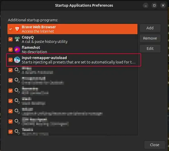

Also, don't forget to add this software to the Startup application along with enabling the Autoload option so that it will automatically map the key once you log in to the system.
starup-apps
