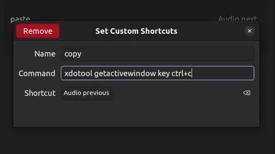

I have created custom shortcuts that have "Audio previous" and "Audio next" as their shortcut. I have installed xdotool and have given xdotool getactivewindow key ctrl+c and xdotool getactivewindow key ctrl+v as their commands, respectively.
Like so:
screenshot of custom shortcut dialog
But it doesn't work. When I press the respective buttons, all I get is a ⦸ symbol at the bottom of my screen for a few seconds. Nothing is copied, nothing is pasted.
How can I make this work?
