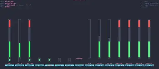

I cannot adjust the volume properly because it would be mute or too loud even at 1%. I'm using a laptop with built in speakers of probably 4-6 internal speakers. I noticed that when using alsamixer+pipewire-pulse, there are PGA playback output controls that I can adjust and the volume controls works well on that, (especially on PGA1 and PGA30).
Other approach that I use is by changing the playback profile from HiFi quality music to Pro Audio can solve this problem temporarily but i have to manually reactivates this profile every time after suspending the laptop.
Does anyone have solution how to make the master volume, speaker volume respects the PGA1 and PGA30 playback slider?
