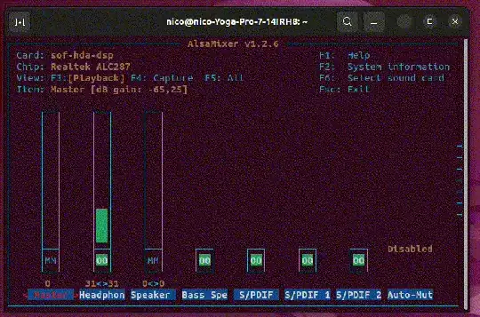

After installing alsamixer I've discovered that increasing the volume using the volume slider in the ubunt applet or using the keyboard shortcut, increases the master channel volume by 53% after one increase and to 100% after two increases. The speaker channel increases in constant small steps. The gif below shows what happens when pressing the increase volume key twice.
alsamixer two volume increases
