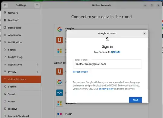

I want to add a Google account on my gnome-control-center online-account. The popup OAuth window for connecting GNOME to Google loads the first page (email), but when I validate, the window freezes and I can't enter my password and validate the connection.
OAuth window freezes:
I get this first window so it's not a graphics driver problem as in this question.
It was working fine until I tried to add another google account (reason for my initial message below), but this may well be completely unrelated, whatever Occam has to say about this.
The problem I have is very similar to this question. I tried both solutions with ENV vars, the first deprecated one WEBKIT_FORCE_SANDBOX=0, and the new WEBKIT_DISABLE_COMPOSITING_MODE=1, with no success.

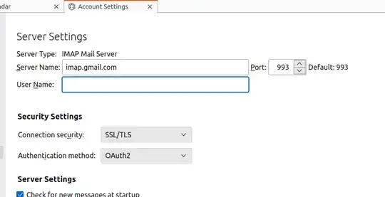

I also tried to had an IMAP and SMTP account, and copy the working settings from Thunderbird, but you can't use OAuth with this option (yet).
Firefox's second Gmail account settings:

Ok. I stumbled upon an answer. Once it freezes, right click on the window. For me there was a reload option. Upon reloading it allowed me to do second factor authentication, then permission selection and I got through the rest of the auth flow.
