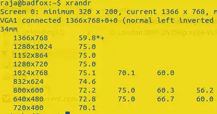

open your terminal and type this
sudo apt-get install compizconfig-settings-manager
then type compiz in your unity dash , it will list you compiz settings manager .Open compiz and at general options click at composite and there you have untick the detect refresh rate then you can manually set the value you want . enter image description here .
and two know allowed refresh rates for the resolution you can use xrandr
the second row are allowed refresh rates with respect to the resolutions . so by depending on resolutions you have set , you can change the refresh rate by using the above methods . enter image description here
