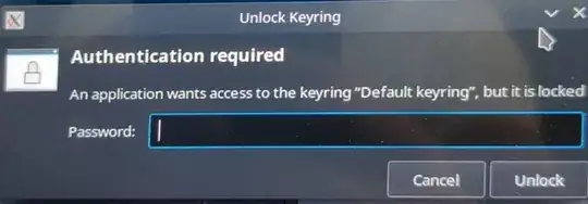

Since then, when I boot my pc, this popup appears, sayng that
An application wants access to the keyring "Default keyring"
Popup asking to input password to unlock the "Default keyring"1
To unlock it I must enter my old kwallet password.

I think I found the answer by myself, this thread on an archlinux forum put me on the right path.
Essentially the popup I see is "Gnome Keyring", and it's installed and used even on a KDE Plasma installation cause some application relies on it.
So when I changed my KWallet password, the Gnome Keyring password remained unchanged.
The solution was to install Gnome Seahorse and with it, change the password of the "Default keyring" and "Login".
