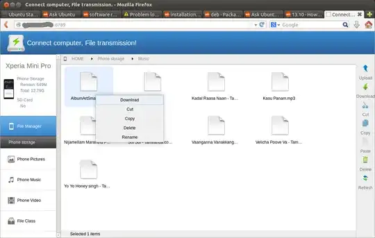

Try the "AirDroid" App from Play Store. It allows you to use a browser based interface (on your computer) to transfer files from a Windows/Linux pc. Since it's browser based UI, no need to install anything on the pc side.
