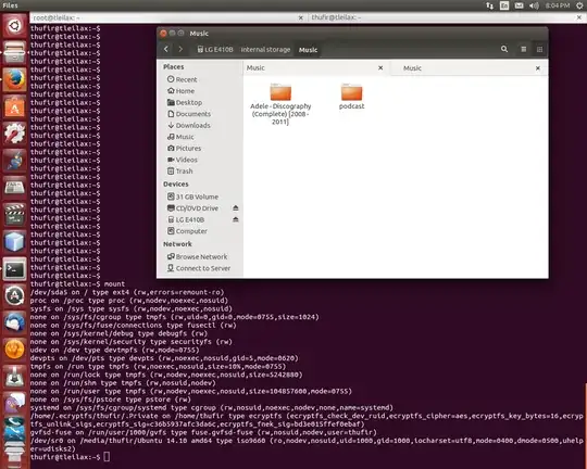

magically, works now:
android
It's mounted?
thufir@tleilax:~$
thufir@tleilax:~$ mount
/dev/sda5 on / type ext4 (rw,errors=remount-ro)
proc on /proc type proc (rw,nodev,noexec,nosuid)
sysfs on /sys type sysfs (rw,nodev,noexec,nosuid)
none on /sys/fs/cgroup type tmpfs (rw,uid=0,gid=0,mode=0755,size=1024)
none on /sys/fs/fuse/connections type fusectl (rw)
none on /sys/kernel/debug type debugfs (rw)
none on /sys/kernel/security type securityfs (rw)
udev on /dev type devtmpfs (rw,mode=0755)
devpts on /dev/pts type devpts (rw,noexec,nosuid,gid=5,mode=0620)
tmpfs on /run type tmpfs (rw,noexec,nosuid,size=10%,mode=0755)
none on /run/lock type tmpfs (rw,nodev,noexec,nosuid,size=5242880)
none on /run/shm type tmpfs (rw,nosuid,nodev)
none on /run/user type tmpfs (rw,nodev,noexec,nosuid,size=104857600,mode=0755)
none on /sys/fs/pstore type pstore (rw)
systemd on /sys/fs/cgroup/systemd type cgroup (rw,nosuid,noexec,nodev,none,name=systemd)
/home/.ecryptfs/thufir/.Private on /home/thufir type ecryptfs (ecryptfs_check_dev_ruid,ecryptfs_cipher=aes,ecryptfs_key_bytes=16,ecryptfs_unlink_sigs,ecryptfs_sig=c36b5937afc3da6c,ecryptfs_fnek_sig=bd3e015ffef0ebaf)
gvfsd-fuse on /run/user/1000/gvfs type fuse.gvfsd-fuse (rw,nosuid,nodev,user=thufir)
/dev/sr0 on /media/thufir/Ubuntu 14.10 amd64 type iso9660 (ro,nodev,nosuid,uid=1000,gid=1000,iocharset=utf8,mode=0400,dmode=0500,uhelper=udisks2)
thufir@tleilax:~$
