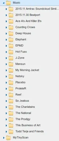

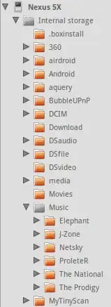

After initially not recognising MTP at all (here) I have an issue with both my Nexus 5 and my new Nexus 5x whereby some - but not all - DCIM (camera) and Music folder content shows up in Thunar. I can see the discrepancy on the phone itself or via AirDroid
Thunar view of MTP connected phone on left, AirDroid view of same on right:
Thunar view of MTP connected phone AirDroid view of MTP connected phone
As far as I recall, all files were added using AirDroid, but at different times. The same happens with camera images. Possibly-helpfully, <=5 day old pictures were listed in Thunar, >=6 day old pictures weren't. Photos taken on same phone in same timezone with no other obvious changes. This is NOT true for the music: Elephant (White Stripes; present in Thunar) was added most recently but before that was Deep House (absent Thunar) and before that The National (present Thunar). No obvious pattern to the present/absent folders.
