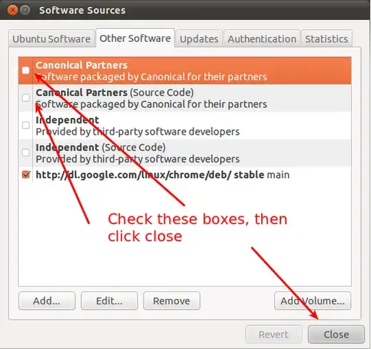

GUI Way:
Click on the ubuntu button, then search for "Software Sources" (or "Software & Updates" on Ubuntu 16.04+) and go to the "Other Software" tab.

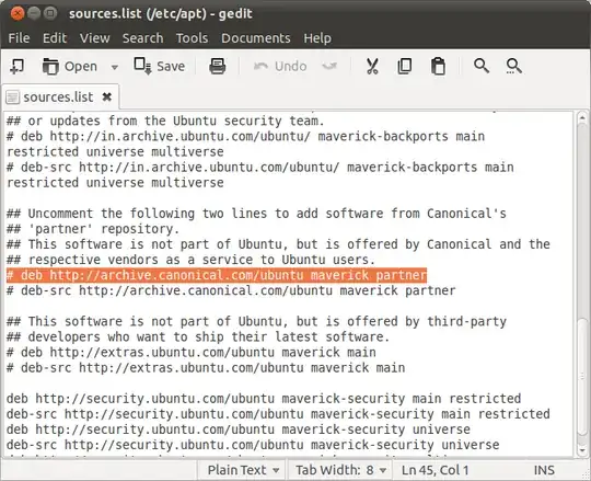

- Open the sources.list file:
gksudo gedit /etc/apt/sources.list(or with the command line editor of your choice,sudo nano /etc/apt/sources.listwould usenanoon the command line without a GUI) Add the partner repositories by removing the # in front of the following lines (
maverickis the version of your Ubuntu installation, it may differ, so use the codename of the release you are using instead of 'maverick'. If you're not sure runlsb_release -cto find out.)# deb http://archive.canonical.com/ubuntu maverick partner # deb-src http://archive.canonical.com/ubuntu maverick partner
- Save and Close.

To enable the partner repository from the command line, edit /etc/apt/sources.list:
sudoedit /etc/apt/sources.list and remove the # from the beginning of these two lines:
#deb http://archive.canonical.com/ubuntu maverick partner
#deb-src http://archive.canonical.com/ubuntu maverick partner
So they are like this:
Then update your apt cache: sudo apt-get update.
