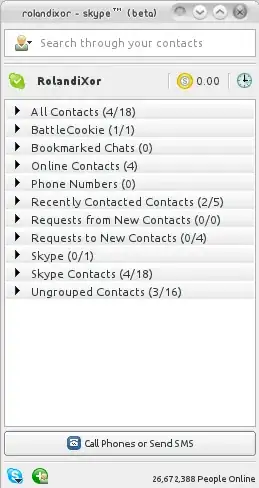

If you enable (this link tells you how) the partner repository within your software sources (and reload the list).
Now you should be able to install Skype in 11.04 from the Software Centre.
Screenshot, it happened.
