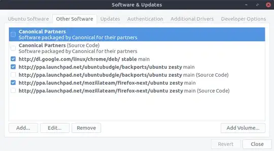

"canonical partners":
It is these 2 lines ...
$ grep partner sources.list
## 'partner' repository.
# deb http://archive.canonical.com/ubuntu xenial partner
# deb-src http://archive.canonical.com/ubuntu xenial partner
or from the desktop (image shows zesty instead of xenial)...
