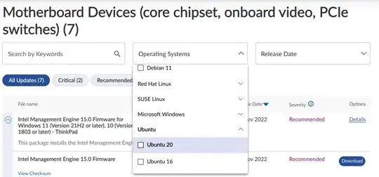

I tried to reinstall the available firmware downloaded from here:
But surprisingly (!), Lenovo is not providing firmwares for Ubuntu 22.04:
And it simply doesn't work:
