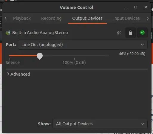

Recently the OS crashed after updating. Then I tried to reinstall Ubuntu. It turns out it can't detect the audio output via the DP port.
Pulse Audio:
The speaker of my monitor works fine. The tricky point is that the speaker works perfectly when I use live Ubuntu from my UFEI USB stick. I have tried both live Ubuntu 22.04 and 22.10. It works on both live Ubuntu versions. I have tried the solutions of similar issues, but they didn't help. I have no idea why the DP port can detect the video in, but not the sound out.
