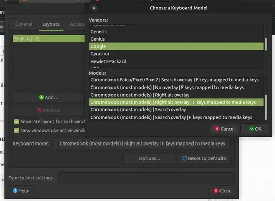

In Ubuntu MATE, open keyboard settings, open the "Layouts" tab, and choose "Chromebook".

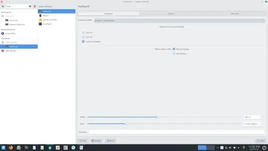

In Kubuntu, open System Settings -> Input Devices -> Keyboard, and choose Google | Chromebook as the layout.

Then, open keyboard settings, and open the "Layouts" tab.
Choose the layout titled "Chromebook (most models) | Right alt overlay | F keys mapped to media keys". Here, the alt key acts as the "overlay" key (similar to the Fn key in usual laptop keyboards).
