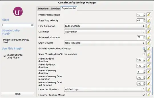

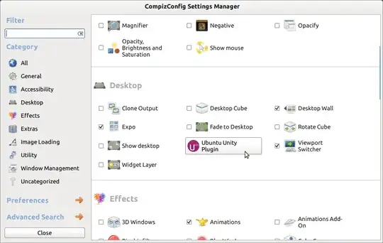

1) Install Compiz-Settings-Manager (sudo apt-get install compizconfig-settings-manager),
2) Go to "Ubuntu Unity Plugin" > "Experimental" and uncheck "Enable Shortcuts Hint Overlay".
