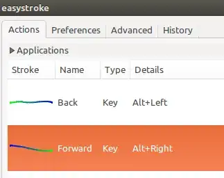

  2. Start Easystroke. To add a new action click the panel icon and in the Actions tab click Add Action. Use the following parameters on "Type" and "Details" (feel free to use a name and gesture that you prefer): screenshot
  3. Set a mouse gesture by clicking Record Stroke and then while pressing mouse button 2 move the mouse the way you like for this action in future.
