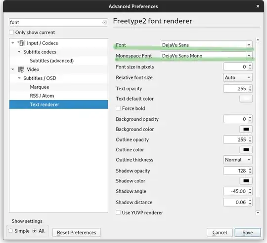

If you can read exif metadata normally in your terminal, then the metadata is written in Unicode. (check echo $LANG) And also check the VLC font settings.
VLCFont.png Otherwise, it is written in another character encode. In Japanese, it probably is in Shift-JIS or EUC.
