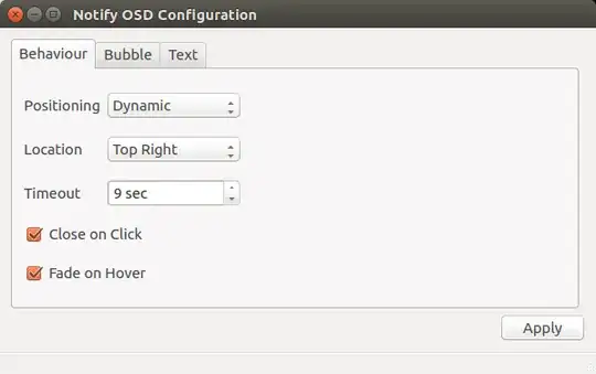

You can't do this normally. However, there is a patched version of notify-osd that supports it:enter image description here

The configuration dialog should be in Applications->Accessories or notifyosdconf from the terminal. There's a setting for the standard notification duration as per screenshot above if you don't set it the --expire-time parameter.

The configuration dialog should be in Applications->Accessories or notifyosdconf from the terminal. There's a setting for notification duration as per screenshot above.
