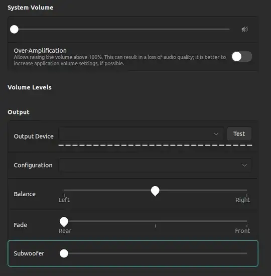

I am facing a problem with my Ubuntu 22.04.1 LTS. Over night I simply cannot change the volume with the shortcuts on my keyboard. So I go to the Settings menu and try to change something there, but nothing happens, in fact, it tells me that there isn't even an output nor an input device. Changing the System Volume through the bar does visually happen, but it doesn't change the volume. What should I do? Thank you in advance. Here is the output
and here is the input
