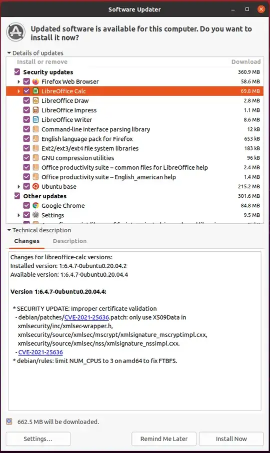

On the GUI side, the Software Updater app will pop up if you decide above. If not, you may start the app anytime you want to update your computer.
The app will check for updates and display the available updates like this:
As you can see, there are both security and other updates available on this computer. You may highlight the upgrade and check the Technical Description. It will list changes from the installed version. In the picture above, you can see the two vulnerabilities were fixed in this security update to LibreOffice Calc. Then you may decide whether to update it or not.
