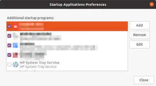

Workaround 2: Stop the Annoying Popup
While the bug gets fixed you may want to disable the hplip-systray using the Startup Application app.
As you see above, I have unchecked the box next to HP System Tray Service.
Once the bug is fixed open this app and check this box. This will return the HP icon in the system tray.

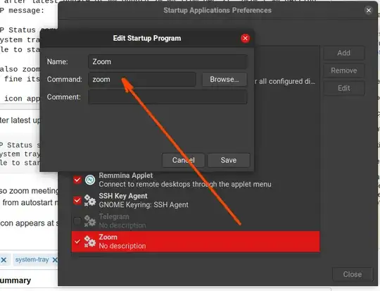

Zoom icon in the system tray
I was able to reproduce your problem. If I set Zoom to start at startup, then the Zoom icon does not show in the system tray. However, Zoom starts.
Please add this information as a comment in the bug report so that the developers know about this.
Workaround 2: for Zoom
  1. Disable Zoom from the Startup Applications.
  2. Start Zoom manually after logging in.
Hope this helps

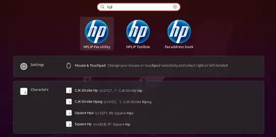

If you wish you can permanently remove the No System Tray Detected message as follows:
In terminal Ctrl Alt T navigate to /etc/xdg/autostart/ and then run
sudo rm -R hplip-systray.desktop
This is the preference of some users who dislike the prominence of the icons in the system tray anyway.
The error no longer appears on reboot but the underlying HPLIP Toolbox utilities are preserved and can still be implemented by accessing the Applications menu (shortcut: press left Windows key and enter hp in the search box) then select the utility required from there.
After removal
How will this affect your system?
the HPLIP utilities are preserved and are still selectable. The absence of it in the system tray does not affect the performance of or access to the printer.
