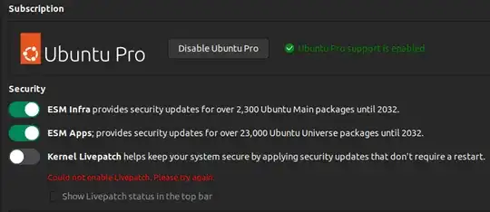

I can't turn on the kernel livepatch option, despite trying many times. Is there anything that I am doing wrong? Thanks
Livepatch is turned on

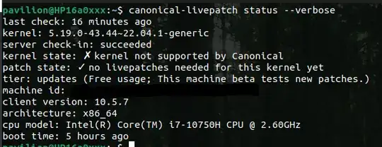

Note the following line in the second screenshot in the question:
patch state: ✓ no livepatches needed for this kernel yet

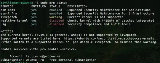

Also note the following lines in the third screenshot:
NOTICES
The current kernel (5.19.0-43-generic, amd64) is not supported by livepatch.
Supported kernels are listed here: https://ubuntu.com/security/livepatch/docs/kernels
Either switch to a supported kernel or `pro disable livepatch` to dismiss this warning.
These lines indicate Livepatch is enabled but is not available for the installed kernels.

Livepatch is not yet available for Ubuntu LTS HWE kernels. The list of the kernels that are supported by livepatch is availalbe here.
You have two options:
First, use the non-HWE LTS kernel. For Ubuntu 22.04 LTS it is the kernel was released with, version 5.15. Since you are already using kernel 5.19 the current HWE kernel, I won't recommend that.
See How to go back from HWE (5.13) to GA (5.4) kernel in Ubuntu 20.04 LTS? for how to go back from HWE to original kernel. The process is similar for Ubuntu 22.04, but it may not work with most recent hardware that needs the newer kernel.
Second, wait a few months when the Ubuntu 22.04.3 comes out. That will come with a newer version of the kernel and it will support livepatch in HWE LTE kernels.
