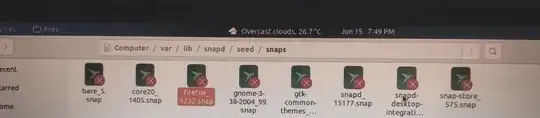

In Ubuntu 22.04 the Firefox snap was installed by default. I removed it using the command sudo snap remove firefox, but inside the filesystem in /var/lib/snapd/seed/snaps there exists a Firefox snap locked package which is about 163MB in size. How can I remove that?

Files in that folder (/var/lib/snapd/seed/snaps) came pre-installed with the operating system. No snap command will remove them. Deleting them manually will remove them, but can potentially break something eventually maybe. If you won't be using the firefox snap, most likely it's fine to just manually delete the file, but there is always the potential that it may break something later.
If you want to install Firefox as a .deb, you can follow the instructions here to install the Mozilla PPA and prevent apt from "updating" to a snap automatically.
