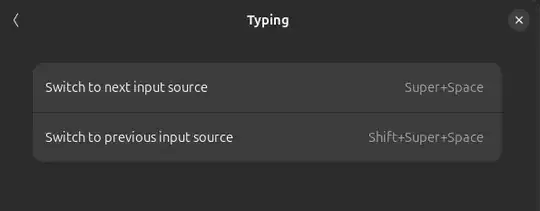

Open Settings > Keyboard > Keyboard Shortcuts (View and Customise Shortcuts) > Typing to confirm changes.
keyboard shortcut settings

For Ubuntu 24.04 there is a shortcut for switching between keyboard input languages. Use shortcut keys Super + Space and Shift + Super + Space to go back and forth.
Go to Settings > Keyboard > Keyboard Shortcuts > View and Customize Shortcuts and choose Typing. There you can find more useful shortcuts.
