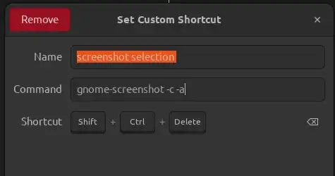

after you log out or restart the computer, the old gnome-screenshot is removed, so you need to reinstall it to make the old command to work.
sudo apt install gnome-screenshot
Add a Custom ShortCuts
Settings → keyboard → keyboard shortcuts → custom shortcuts
Custom shortcuts are at the end of list
gnome-screenshot -c -a
I'm using Shift + Ctlr + Delete shortcut so that it doesn't interfere with the new 42 screenshot shortcuts."
