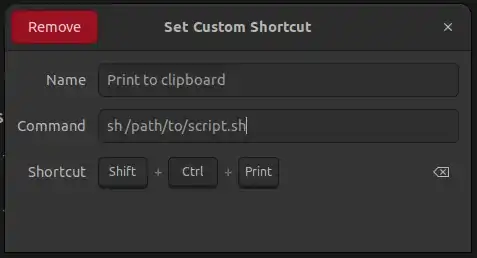

  5. Go to Settings → KeyboardView and Customize ShortcutsCustom Shortcuts.
  6. Add it as shown in the following image:
Now for saving the screenshot to a specific folder, I couldn't find a solution for the default GNOME tool, but if you are going to use gnome-screenshot anyway, an option is to create another custom shortcut for printing with gnome-screenshot, with a command like this:
sh -c 'gnome-screenshot -af /path/you/want/it/saved/$(date "+%Y.%m.%d-%H.%M.%S").png'
