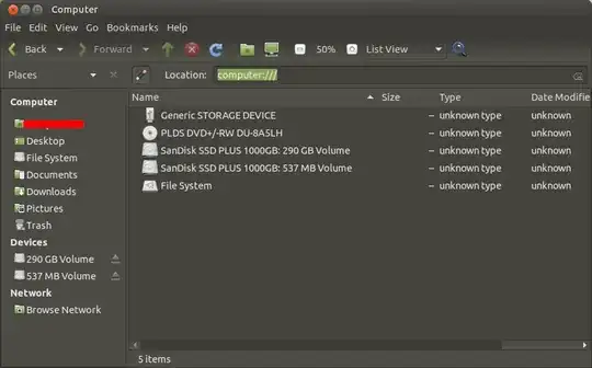

How can Computer view be displayed in the Caja file manager in Ubuntu MATE 20.04.3?
the location is computer:///
Nautilus has it under Other Locations, but caja has no clear way to reach that location through the menus or buttons.
After unmounting a usb drive it accidentally came up: enter image description here
And BTW, why aren't total, available, and used amounts shown in this view like in System Monitor? It seems a simple and useful feature.
